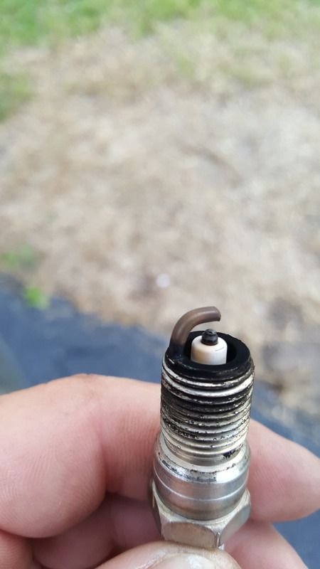

Finally had a chance to check it out this morning. I checked the float level once again and no change there. Pulled the plugs and took some photos. This is a DD boat and these plugs have approximately 7 hours of mixed use. Sorry for the size I don't know how to resize in photobucket. Cylinders 1,3,5

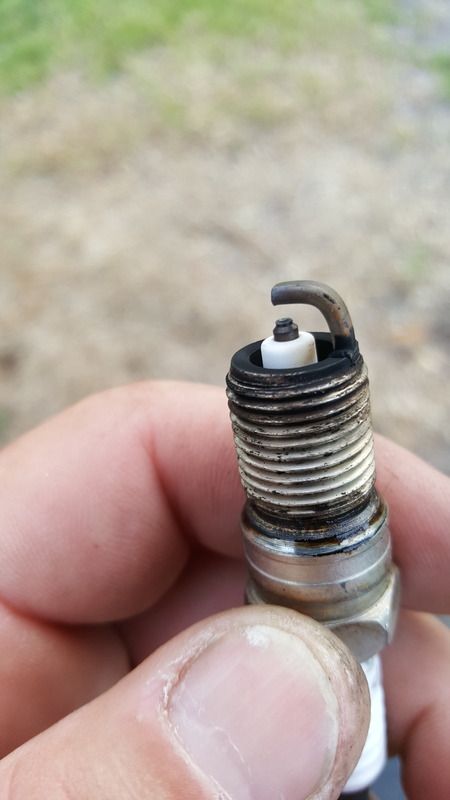

Postby Alvarez1112 » Sat Dec 03, 2016 8:19 am
2,4,6

Looks lean. The white porcelain should be the color of a brown paper bag if the fuel mixture is correct. What temp is the engine running? A lean engine will run hotter.

I'm not too keen on reading plugs at this point, but to me the mark on the ground strap seems like it's a little cold, and the mixture looks a little lean, but the carbon on the base ring throws me off a little. Again I'm still learning the whole plug reading thing

28 degrees at and idle is way too much initial timing. That will clean the plugs when idling. My suggestion is to unlock the mechanical advance. Idle timing at 12-16 degrees and all in at 3000 ending somewhere between 32-34. The carbon ring is most likely too much fuel at 3000.
