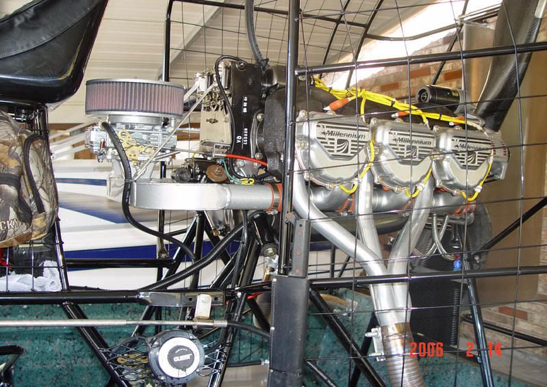

ok is the two barrel Holley just better compared to the other two barrels or would a four barrel add more power?or is the reason to stay with two barrel simple fuel economy? here is the reason I ask I just started building a 220 case with 550 jugs and figure I will have to fabricate a intake that comes to the front of the engine and I have a 4 barrel Carter (old model with is now Holly) laying around extra and i was thinking of use that but if the two barrel is that much better I will start looking for one
Gold, The predator carb works very well on the gpu/520 conversion. JC Stanley builds an intake for the gpu conversion to adapt a holley or predator. Skeeter has run both carbs and likes the predator best.
I can build a aluminum intake adapter just have to decide if I want the carb in front of the engine or on top and what carb to use . I was leaning towards the four barrel just because I had one and would not have to buy a new one but it sounds like I should just buy one of the two barrels
The Predator works the best but the other four barrels don't run any better then a 500CFM 2 barrel. I ran a 390 CFM , 450 CFM, 500CFM, 600CFM and 650CFM four barrel and the 500CFM two barrel out performed all of them
77 jets, 10.5 power valve. on the 500 2bbl holly.
also the rise (from top of the flat part of the intake to the bottom of the carb flange should be 3.25 to 3.75 inches, not just flat on top.
Also a problem I had on my GPU was I had to put a piece of sheet metal on the back of the filter element (toward prop) to keep the prop from sucking air/fuel out the top of the carb. When the filter would turn around, the motor would run crappy.

the plate if I understand correctly is mounted behind your carb witch is on top of your engine like a standard GPU (right?) would I have the same problem if I mounted in front of the engine like this picture? picture is one O found on airboat trader but is how I was thinking to build my intake would I still need the plate or would that be far enough forward to not bother it?
