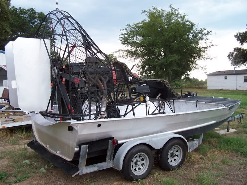

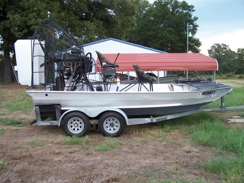

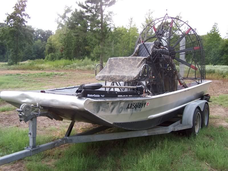

I have a 10 - Blade Warp Drive Prop on my Airboat at the present time. After asking a few questions on here, it seems like most think it will take a 3 - Bladed Prop to be able to run my 16' X 8' - 454ci Airboat across dry solid sand bars. Speed is not a big issue, but would like to have as much as I could and still have the ablity to run dry.
So the question is:
Who makes the best 3 Blade Prop to if my need ? ? ?

Looks to be a slider hull. When I had a Airgator slider, I had problems running dry until I installed jacks. Seems like I flattened the bottom over time and as soon as the jacks were installed I saw a 100% difference.
Looks suspiciously like a Marks Airboats Robicheaux boat to me. Sweet ride for certain.

I'm with cntry, look real close at the bottom of the hull. bbc belt drive pullin a ten blade is pretty much a go anywhere you want to boat with in reason.I'd be interested in prop width and pitch ,maximum engine rpm and what reduction ratio just for kicks though.
However I do recall some of the worst stuff to be on is damp sand it seems to conform to the design of the hull have seen a few 502's turn 3 blades with a lot of reduction havin to un ass there boats to get off the sand bar at the creek while dd caddis with wood props could wiggle on off loaded down.
The rivers I am usually on are wet sand, and loose sand. So basically, I guess it is kinda like trying to get started on a piece of sand paper. Like I said, I am a rookie, so we are learning and checking things as we go. The polomere on the bottom doesn't have any gashes or big cuts in it at all. It really looks pretty new.
I am not sure what the max RPM's of the engine is set on, I will check that out, but I am understanding that the 454's power band if in the 3500-5000rpm range.
