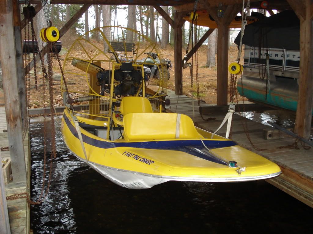

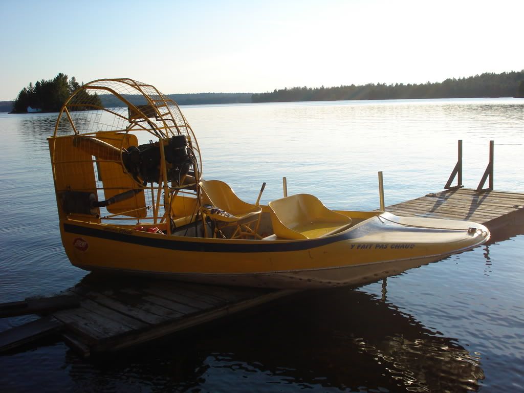

Post pics.I'd like to see how they put a holley carb on a 180.I don't think you have a lycoming 180.Are you sure its a lycoming and not a Continental,or is it even a holley carb?
I'm trying to get a couple of pics uploaded, it would be a lot easier if one could use a wrench to make these PC's work.
I'm sure it is a holly carb on a Lycoming engine (per stampings on the carb & valve covers).The intake manifold is stamped with "For Air Boats Only".
Once the pics are posted you folks can better help me identify the set up.

It looks like a sump from a helicopter engine.
with the carb being up in front of the engine
it tends to change my line of thinking.

What a nice old "glass-slipper" :headbang:
Well the carb set up is beyond anything I could have imagined! Now it's easy to see the problem, so maby someone will come up with a novel solution.
