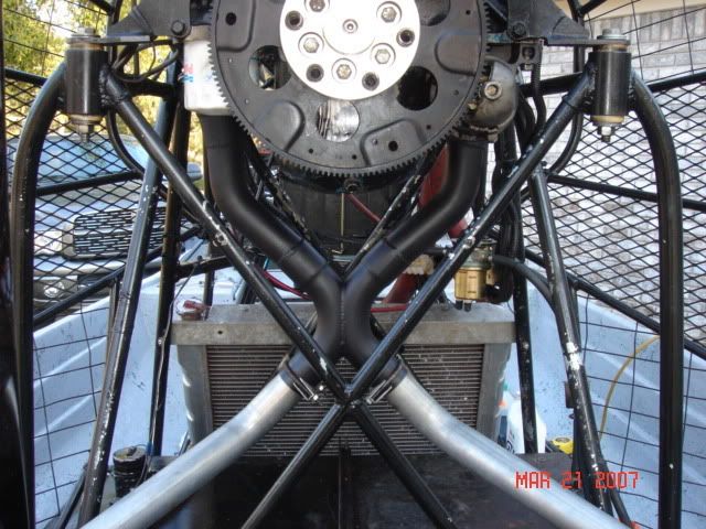

A while back, there was a post with a picture of a cross over exhaust on an aircraft powered boat.... I think the the fabricator had a flex joint coming out of the headers and then a couple of 45 or 90 degree angled pipes coming together ( cut and welded) and then exiting back to mufflers. I did a search, but couldn't find it ...Can anyone point me to the post ? thanks

Joe, PM me if you need info on it. I've got about $900. in the system including mufflers and its not finished yet. Honestly it helps with sound levels but is costly. A really good set of mufflers is cheaper.

This the one Joe?

I think it could help performance better than a 4-into1, but that one pictured is BIG $$$$$$
Cowboy, that's a beautiful system but it's so tightly built in around the oil pan that it would heat up the engine big time on an airboat. It was designed to be able to get everything inside a cowling on an airplane, where the airflow could be controlled.
Used as a model though, with the crossovers dropped down a couple of feet, it should be an excellent airboat setup in my opinion.

I saw that picture on an a/c custom exhaust site, and you could get a good running used boat for what they charge for one!

I would rather have some headers with longer tubes but I am just runnin the block hugger headers that were on it, about the only good thing about them is that I can make the exhaust tight and streamlined like that. I bought a universal x pipe kit from Jegs and it fit great. I pickup up about 100-150 rpm with the new 2.25" x pipe exhaust over the old dual 2.5" it had on it.
Northwest, you've just proven a point I've been trying to make for some time.
A properly designed exhaust system doesn't have to cost a fortune to be quieter, and it won't kill your engine.
To the contrary, it will make more torque than open pipes. :)
