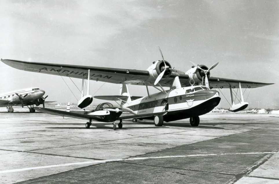

My comments (so far)
It seemed like a simple question.
It is done all the time to airplanes, some with thousands of pounds of thrust.
Airplanes are designed to withstand the loads of static full power runs and it is done all the time. (every carrier launch for example)
This one was designed in the 40's and will take it.
An engine stand that cannot withstand a full power static run is unsafe in my opinion. That should be a design criteria considering the ramifications of a failure.
