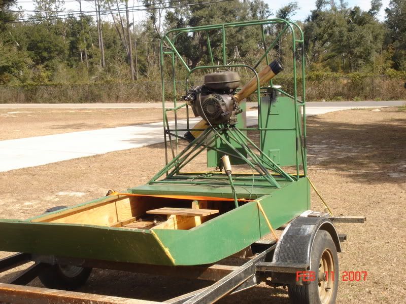

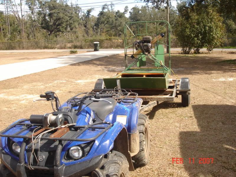

I just picked this little air boat up and need to find out what size prop I need to run on it I has a 25 hp kohlor motor but It needs to be rigged out for the engine but looks like alot of fun.
hey thin If you want to make a mold off of it your more than welcome
