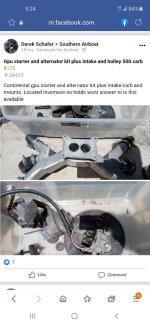

A manifold plenum modified to hold the Holley is needed, replace the o-rings and hoses while changing it out, there are many out there due to blown engines, saw one on a Facebook airboat page, if I see it again, will post a link or a number, had a carb as well as a couple other parts.
Thanks John. Just sent the Zenith out a few weeks ago to be rebuilt. But I will definitely keep an eye out for one for future issues. If anyone knows of one, please holler.....
