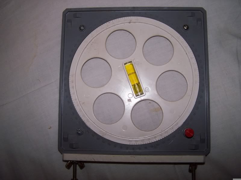

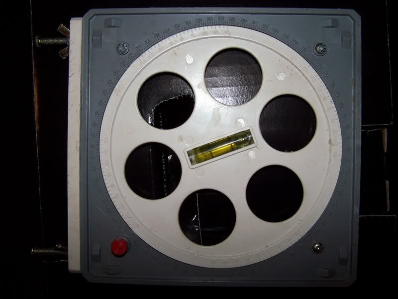

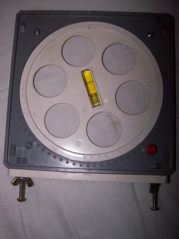

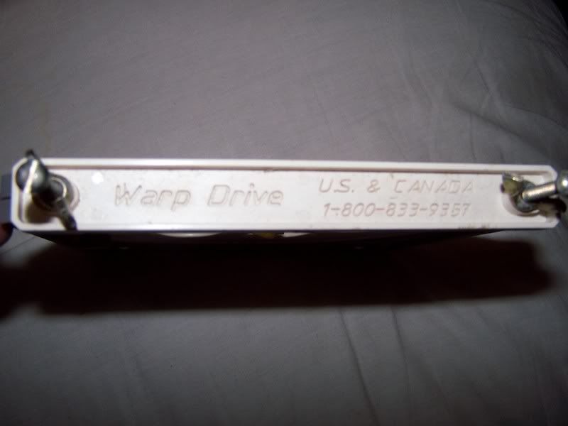

I found this tool on the Airboat when I bought it, and figured out it is for setting the pitch or angles of the prop.
It is a Warp Drive Tool, will it work for a Whirl Wind ? ? ?
What else will I need ? ? ? (I Have a Level & Torgue Wrench)
How to read the Tool ? ? ?

Yes you can use it for your prop. The only other tools you will need are the wrenchs for the prop. The Torgue Wrench is a must so you will need sockets.
I'm sure someone will correct me if I'm wrong.
If you have room put the blades and hub together and then install on the motor tighten but don't torque them down yet.
You need to zero out the bubble by placing the tool on the end of the hub and then zero it out
find a place on the outside of the cage and so you can put each blade in the same spot.
Now when I put my Whirl Wind on I used the marks on the hub to get where I wanted to run my motor (22 mark @ 4500rpm) and then use the dial to fine tune it
You'll need to set one blade for a set mark and then use that to set the rest of the blades
You can call the 800 number on the dial and they will fax or email you on how to use it.
