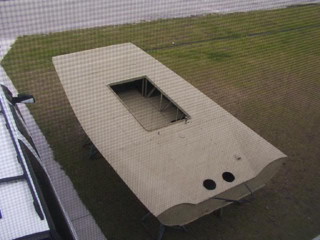

I got tired of waiting for the wind to stop so I painted today anyway. used a SEM self etching primer this morning then put this base color down this after noon. will have to make some stencils to do the patterns later.
I decided to leave this cage and stand black and was thing about leaving that full metal rake black but now I am having second thoughts and may paint the rake this same base color
