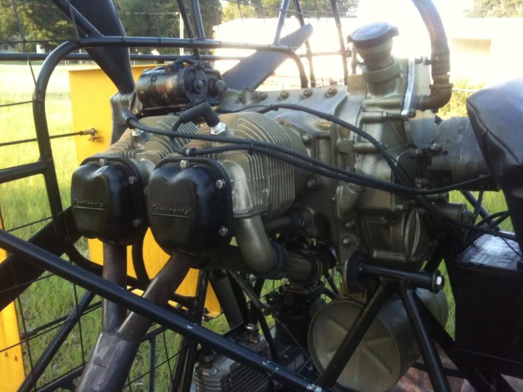

but picked this boat up the other day and the guy told me that it was 100hp
found out I have a pe-60 case but cant quite figure out what cylinders I have on it also I was wondering if a o-200 oil sump will fit on this motor

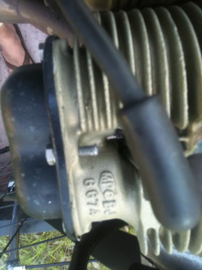

Pretty sure it is a pe-60 by looking at the accessory case and a spot on the top of the engine case but ran the # on the carb and it is from a lycoming o-235
I thought it was a o-200 first time I looked at it not giving much though of it but now i got to get the carb right on it

it is not a gpu if it was a gpu it would have carb on top and the oil cooler is attached the back of the block It lookes like a 85 hp or a 100 hp just dont have both mags for a reason or another but still a good reliable motor not a powerhouse but reliable

By the boss on the top of the case where the intake would bolt up, the oil filler cap on the front cover and where the starter is mounted it sure looks like a PE-60 to me with C-90 jugs and intake, if this has the flange for the belhousing to bolt to "ie" where the rear mount, starter, alternator is.

That's what I was kinda thinking myself I have seen what all the "a" "c" and o-200 motors look like and what the cases look like and this looks like none of them I just wasn't sure if c90 cylinders would bolt to the 60's case with no mods

Sure, throw some new oil at it and check/ clean the screen as well it cant hurt, if it does not change the oil pressure issue, pull the pressure relief valve and make sure it isnt hung up for some strange reason, the screen has no bypass and the relief valve is directly over the stbd engine mount in the first picture you posted.
