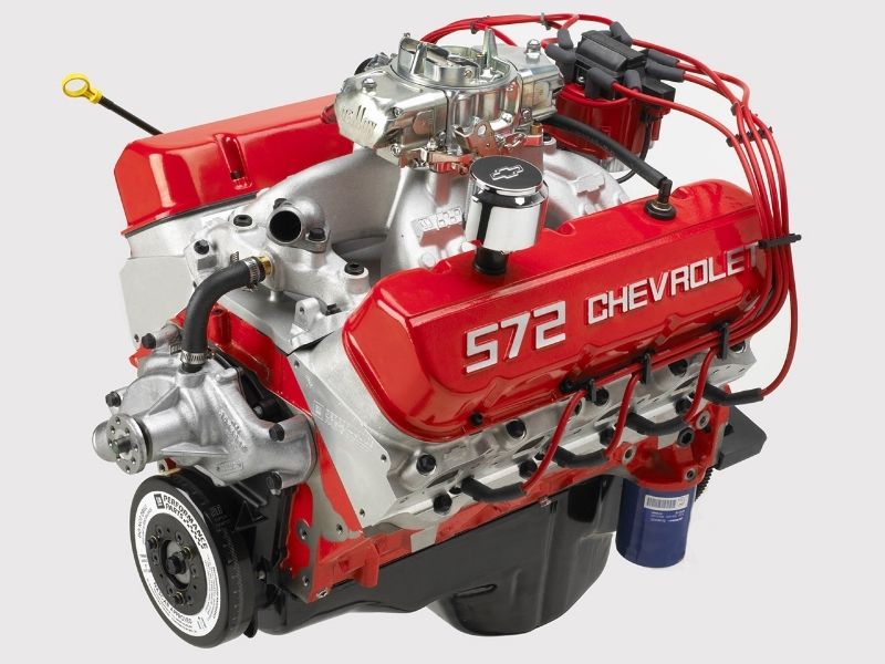

Why would Chevrolet ship the engine this way from the factory if you don't need it? If you have a nipple on the top of your radiator you can run that burp tank hose to that. Alumitech does connect their burp tank to the top nipple of the water pump. GTO doesn't use a burp tank, only an overflow tank. They have an inline fill cap just before the thermostat housing. Alumitech is the only builder I've seen that doesn't connect the waterpump to the thermostat area. Image
