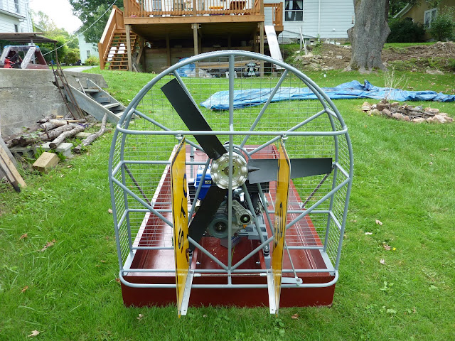

Personally I like the road sign rudders. And I like that you have NOT painted over them. That way, they keep their redneck authenticity. :lol:
As far as I know, it's not illegal anywhere to possess old road signs, or of any requirement to be able to show proof of where they came from. ( I may be wrong on that, but I don't think so. )
Recycling them for rudder duty is just the "green" thing to do. :toothy7:

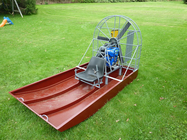

so I got it out on some water today. I mostly putted around getting the feel for it. I was thinking about decking over the back 1/3 and I definatly will. next time I'll build the sides taller. these are 9.5 inches and I think about 12-14 would be good. I think it will plane out but... when I was going for it I hit a rock and cracked the plywood bottom :banghead: now I've got to figure out how to be rock proof and light... hmm.... sheet metal? fiberglass? poly? I'll figure something out.

some more pics. you can see the crack in the hull in the last pic. it's right in the middle between the engine and the seat, look right below the valve cover. i'm thinking i'll cut out the crack, epoxy in a patch then maybe put a few layers of glass over the bottom. also mcmaster has 3/16 uhmw poly for $145...

you did a fine job .. looks great and the effort shows. unfortunately you are going to find out that with low hp setups weight is your enemy. A boat with a narrow bottom print will run faster in the water than a wider boat but it takes nmore power to get it going and more time. A wide bottom gets on plane so to speak faster but will go slower but all require a certain hp for the combination to work. I am not sure I can give you an exact hp number per pound of weight .. hadn't never given it much thought becaus enever went below 35 hp with reduction. That is barely adequate for water operation on an approx 6 to 7 wide hull with a weight of around 200lbs for just the hull. It will carry two normal people ok but add a third or a good cooler or several bags of frogs and it is noticable quickly. .... hope ithis gets ya to thinkin .. but seriously your work looks good .. very good.

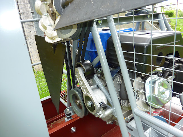

Hey Riley, Im doing a similar project mine is a little larger it is 6X10 with a little rake. Its coming along pretty good I'll post pics eventually, anyhow I was wondering where you got the prop from? it looks like a hovercraft prop is that correct?
Camp Ramblin' Rose
Bob "Koon Dawg" McDonald Grandson
15' Rivermaster 350 2.12 gear box 79" Wisper tip
Riley
Posts: 22
Joined: Thu Nov 25, 2010 7:45 pm
Location: Upstate NY
Re: 8'x4' mini
Post by Riley » Mon Mar 26, 2012 11:57 am
yes it is. I worked with Jason from Slipstreamhover.com.

very nice mini.i built a 4x8 for my son a couple years ago.lot of fun.i really like your reduction.very ingenious.i put a 20 hp onan on mine and it was heavy.made the boat kinda tipsy and it never really performed direct.when i was a kid growing up in the everglades road sign rudders were the norm.times change though i guess.

T :lol: thats funny, my runners go from stern from the tip of the nose too. Cool mini though, like the bug in previous pic. I also use junk parts sovdont fell bsd bout the road sign rudders. I like to think of folks like u n me as innovators. :florida: :toothy7: i luv this website!
