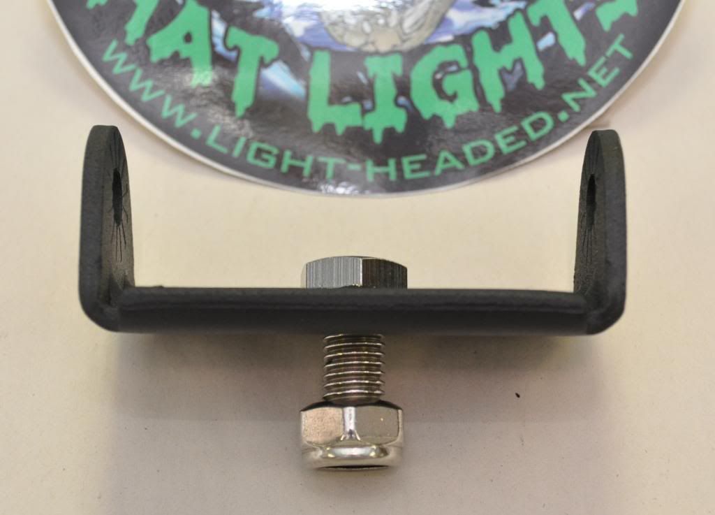

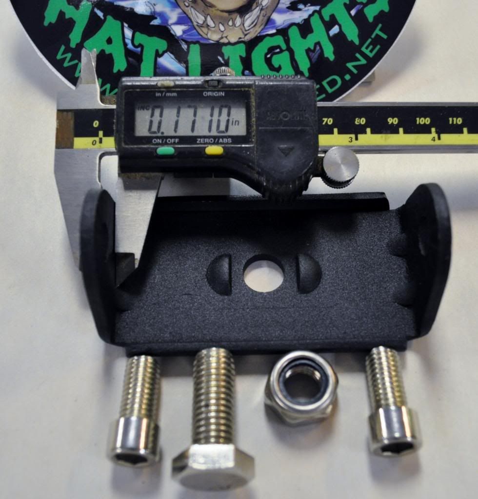

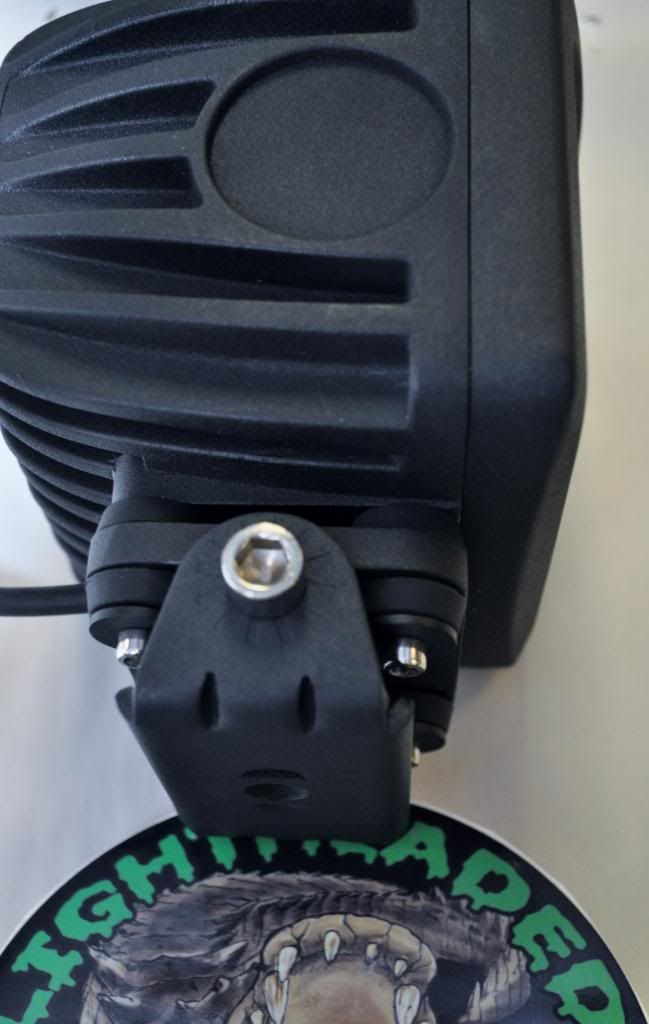

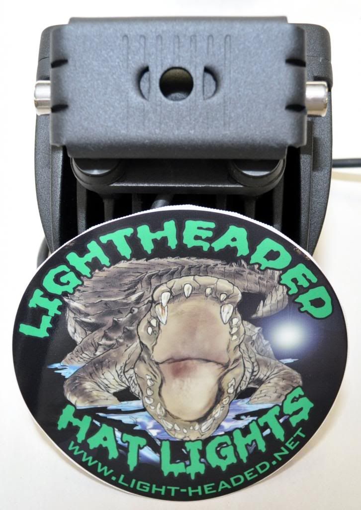

Post by PeaRiverOpossum » Tue Nov 04, 2014 9:57 pm
Duece wrote:Can anybody put some good clear pictures of the mounts?
Duece
Which mounts are you looking for Duece? Here is a pic of the cube mount:
Image[/img]
Image[/img]
Image[/img]
Image[/img]

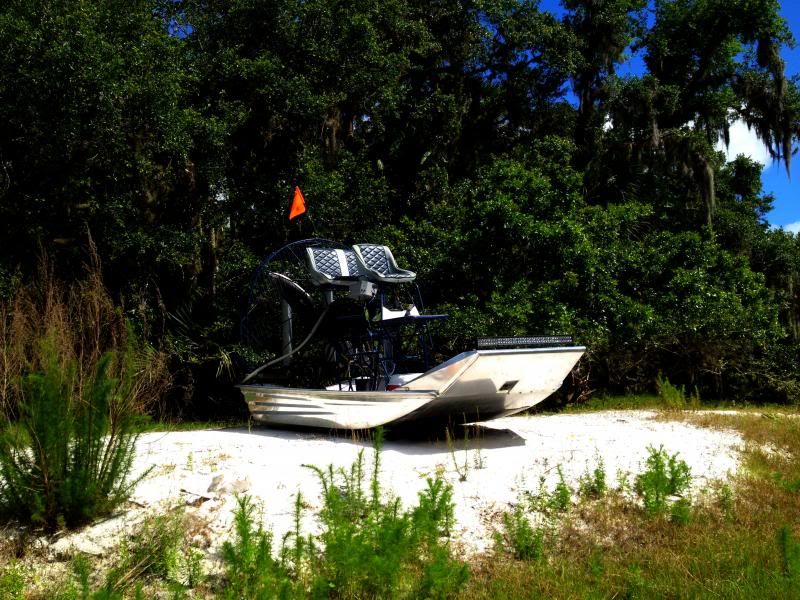

Post by Hog Guts » Sun Jan 03, 2016 10:14 pm
I like what I have.... ImageImage
There are two pics that show light low profile and how it's mounted just custom brackets you can fabricate whatever you need for your rig.
