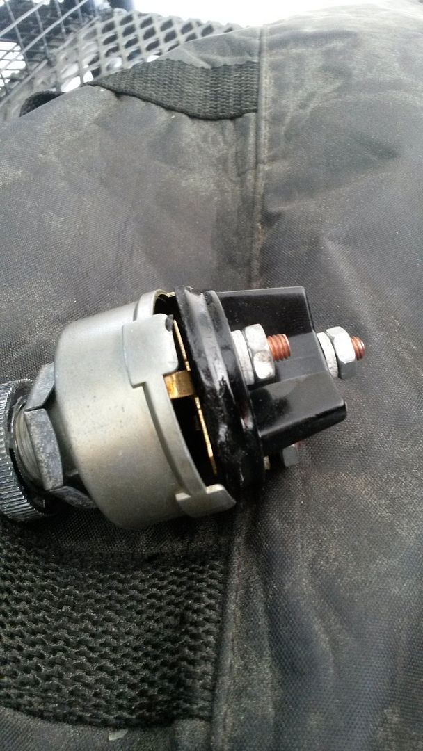

Re: help !! 2007 gto airboat 350 starting issue.
Ya the boat spent all its life in Illinois. Stored indoors. I did clean up the wire that connect to the starter and to the engine block. The battery ground is to the engine block and I also cleaned that to. As far as the ignition where you stick the key in I only clean the wires that connect to the back of it. I didn't connwxt straight. To the battery. The starter was tested at the store works perfectly. So how much is a new ignition and is that what u guys think. Or any ideas. Thanks for the help !
That's a nice ignition switch ! Does everyone agree that's the problem?
Cool I will replace the ignition switch. Another mechanic suggested I run battery one directly to the engine instead of through the perko switch he says it's better to run it direct better connection. What you Guys think??
Thanks everyone for the help it was the ignition switch. Now it works perfect and starts on the first try every time.
