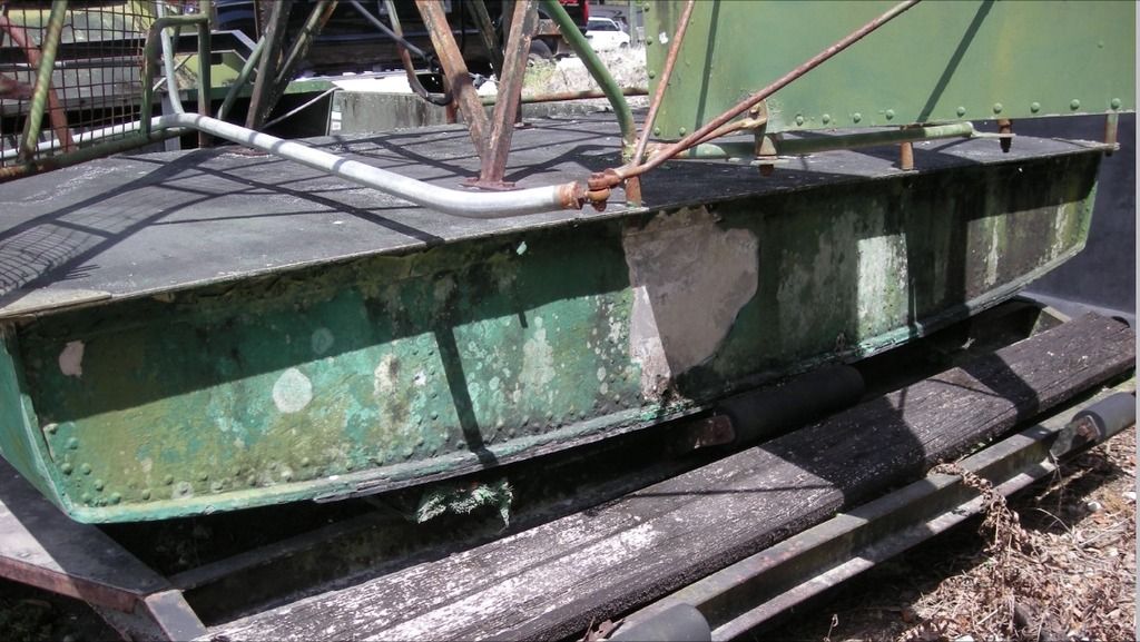

Anybody know who was building the riveted hulls for Broward/Dade County Fish & Game in the 80's? I just picked up a project boat at auction from the Florida Forest Service, and they said it was donated to them by Fish & Game about 15 years ago. It still has their insignia on the rudders. I know they had 11 or so Thurmans built in the 90's, but this hull is titled as an '89 and Im pretty sure it's not a Thurman. 12x6'10 half deck with a backing plate; the guy from the Forest Service said he thought it was a Taylor, but since Taylor passed in '82 I doubt that. Anyone know who was building the warden boats in '89?

It might be a Colinger, I think Jammie built some government boats. Got any pictures?

Gary S wrote:It might be a Colinger, I think Jammie built some government boats. Got any pictures?

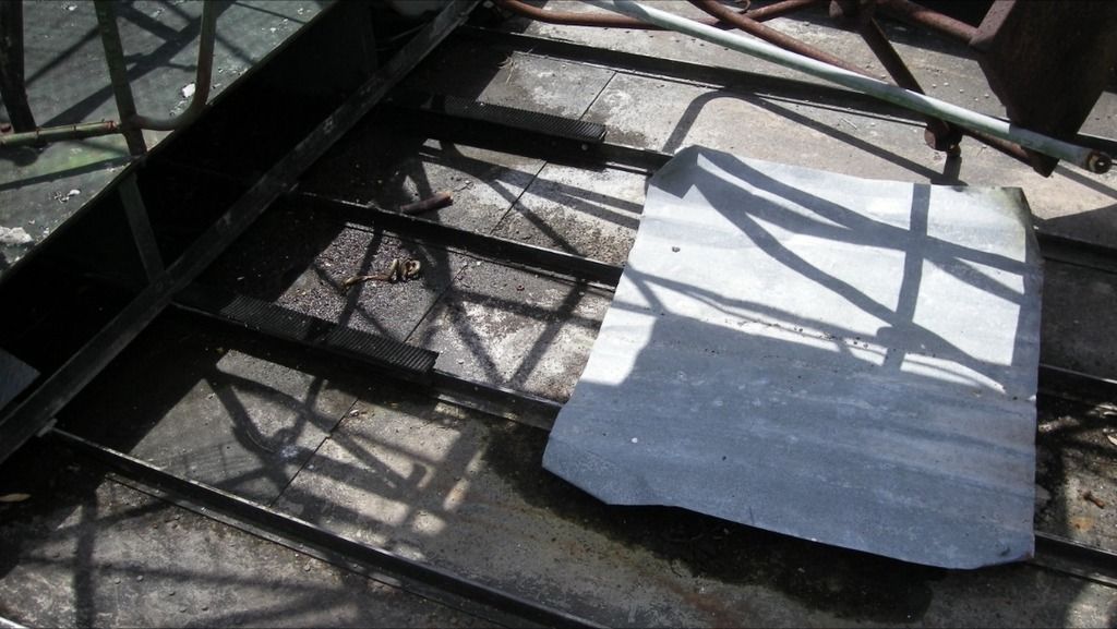

Here you go thanks. She looks rough from sitting 15 years, but the hull is actually in great shape; no corrosion, dents, or damage anywhere. The boat is built well with 5 stringers 12" separated and a backing plate that goes across all stringers from the bulkhead to the transom. The hull under the engine stand is fully boxed from the transom to the bulkhead to the stringers to the deck with aluminum plate; it's definetly built strong.

Gary S I think you're right, it looks like a Cloninger. Found this pic of a Cloninger in the gallery and it looks to be the same; the transom is identical.

Seven3 wrote:The boat is built well with 5 stringers 12" separated and a backing plate that goes across all stringers from the bulkhead to the transom.
My error, the backing plate doesn't end at the bulkhead, it goes about a foot beyond it. Once the plate ends the runners bend down and are riveted directly to the bottom sheets, which I'm told is a characteristic of Cloninger's older boats. Looks like I have it confirmed as a Cloninger, thanks for everyone's help.

Seven3 does the sheet of aluminum run underneath the stringers or is it cut to fit between them ?
I'm asking out of curiosity because on my boat has the same thing as well but I am not sure who built
The hull.

Cloninger put stringers in a press to kink the relief of the backing plate.

0360 the backing plate runs under all of the stringers, then the stringers bend down to contact the bottom sheets where the backing plate ends.

John Fenner wrote:Cloninger put stringers in a press to kink the relief of the backing plate.
Yep, that's how this hull is built. Thanks again for the help.

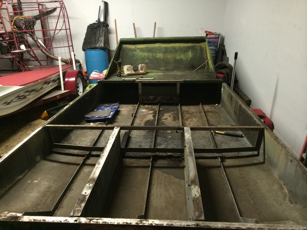

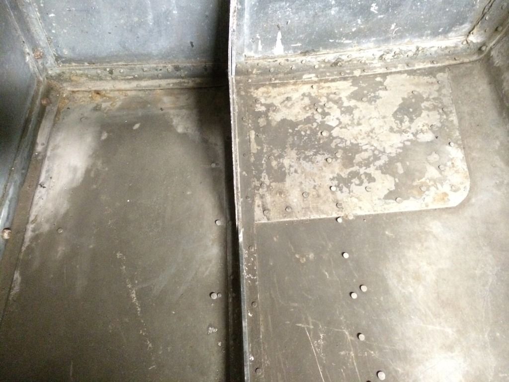

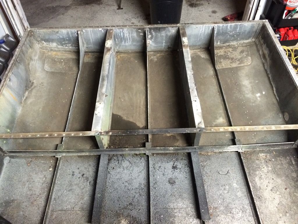

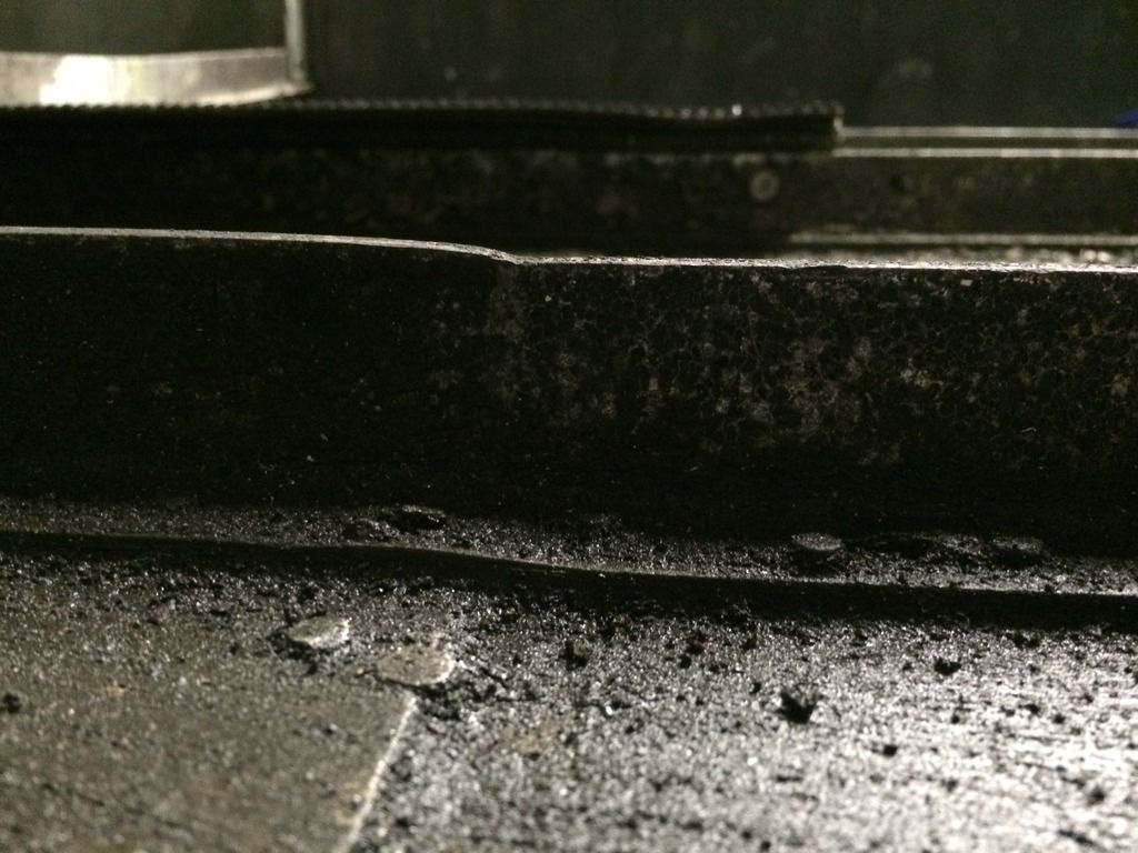

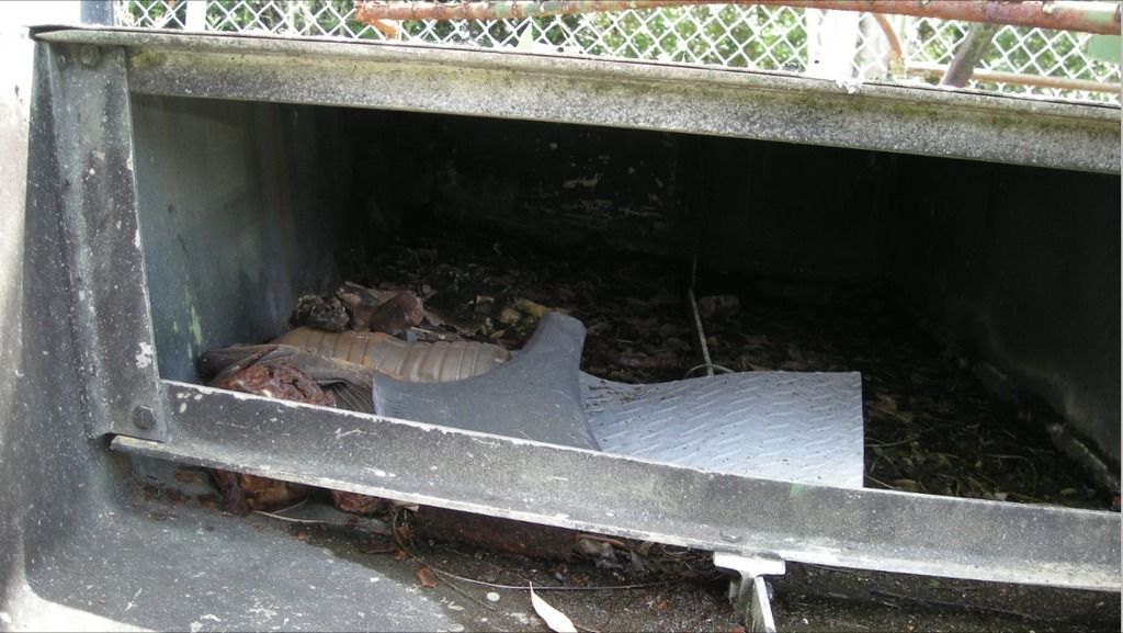

Did some tear down. The hull is built pretty stout: .125 bottom, backing plates, and the T- bar stringers that run under the engine stand are 1/4 instead of the usual 3/16. After taking the rear deck off I noticed there are also backing plates on both sides of the large center backing plate, to contour to the chines. So with a better look and the deck off, is Cloninger still the likely builder?
Here is one of the two smaller backing plates that contour on the chines. The center backing plate runs between the 5 stringers from the transom to about 18" past the bulkhead.
Here's the 'pressed' stringers where the center backing plate ends.
Gary S
Posts: 1739
Joined: Wed Mar 03, 2010 3:30 pm
Location: Redlands
Re: Francis Taylor hull request
Post by Gary S »
Jamie built a tank to run the rocks west of town and south of Loop Road. Poly wouldn't stand a chance going where that boat was built to run.

John Fenner
Posts: 2909
Joined: Tue Feb 14, 2012 12:26 pm
Location: Miami(Cuba) Fl.
Post by John Fenner »
Cloninger did that to all boats with backup plates on last picture. Not all had the full gussets from transom to bulkhead but this one does.
