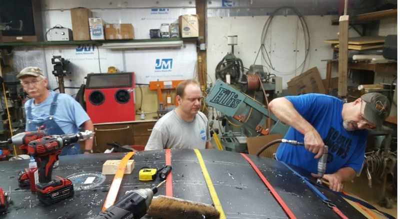

This past week we decided it would be a good weekend to do poly since we were waiting to get the rest of our parts powder coated. So I called John Hagen in Onalaska, WI to see if it would work out. He said we were a go. Then I called Mike Moeller from Holmen, WI to see if he could help out. He said yes and he called a good friend Ira and we were set. Prom at school this week so no helpers from school. I took off my only personal day on Friday, loaded up the boat and headed up to Johns pole shed. Mike meet me there and we flipped the hull over and placed on another trailer upside down. Joey, Johns grandson came over and we strapped down the poly so it would take a little shape in the sun and in the shed it went to start heating up. Saturday morning my brother in law Mark Smith called and asked if he could help, so we all meet about 10:00AM and John had the poly up over 100 degrees so we got started. Things went really well So here is a Big Thanks for all your help Guys THANKS
We had pizza to celebrate and I hit the road for home. The last picture is the hull with some hydro turf stuck down on the deck.
Oh sorry Ira for putting you in the pictures but O'well.
Thanks for taking pictures Mike
